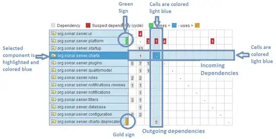

For instance, a very handy view is this one:
Sonar Design View
It allows you to see the connections between different components in terms of dependencies, so you know that a change to this component might impact the other ones.
Read here for more.
Again, it doesn't really tell you that at the method level though (it relies on the dependency graph of the binary dependencies of your build).

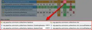

Update: Actually, looks like Sonar even does method level tracking (see the SonarSource blog I linked above):
Sonar Design View with Method Tracking
