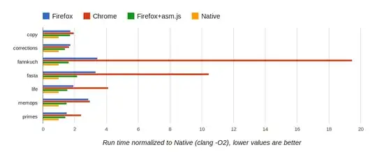

An asm.js application is very fast (near native C++ speed):
http://kripken.github.io/mloc_emscripten_talk/micro4b.png
But how is it possible to write one in C++, convert it to LLVM code, then do some trick with emscripten/asm.js ? I haven't found any tutorial about it.
And if I write the code in C++, then how to use the js API-s, for example XMLHttpRequest, WebSockets, Canvas or WebGL?

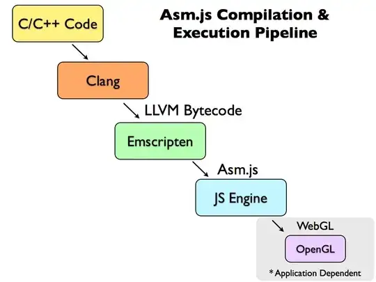

Starting with this image:
C++ => clang / LLVM => emscripten => JS engine
you can see that asm.js is a translation target of emscripten. Emscripten handles translating the LLVM bytecode into JavaScript, and asm.js is a subset of JavaScript. Staying within asm.js' restricted subset of JavaScript allows the code to be optimized and run faster.
