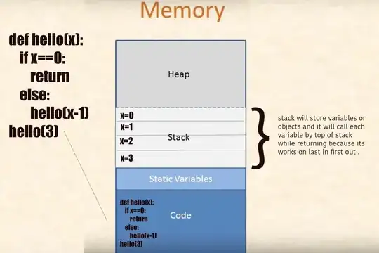

Let me explain how stack works:
First you have to know how function store in stack :
Heap store dynamic memory allocation values. Stack store automatic allocation and deletion values.
Let's understand with example :

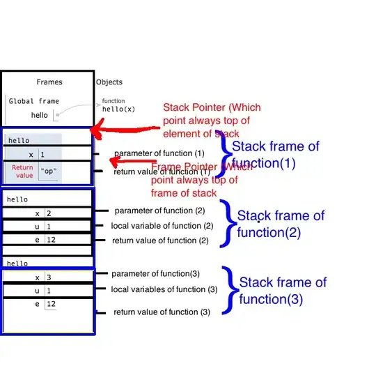

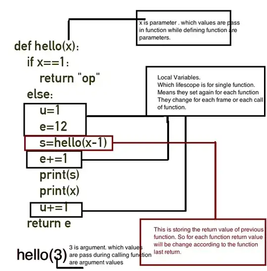

Now understand parts of this program :
Now let's see what is stack and what are stack parts:
Allocation of the stack :

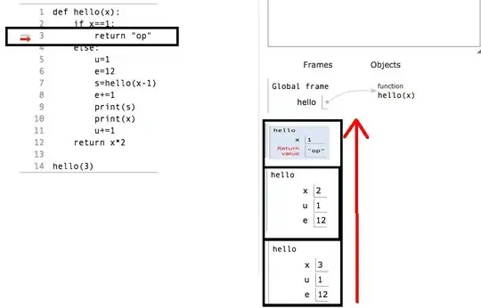

Remember one thing if any function get “return” no matter it have loaded all his local varibles or anything it will immediately return from stack will his stack frame. It means when any recursive function get base condition and we put return after base condition so base condition will not wait to load local variables which are situated in “else” part of program it will immediately return current frame from the stack and now if one frame return next frame is in activation record. See this in practical:

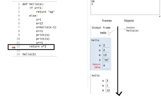

Deallocation of the block:
So now whenever a function found return statement it delete current frame from the stack.
while returning from the stack value will return in reverse order of order in which they allocated in stack.
