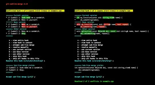

The other answers here are all on point, but to me this always seemed like an unnecessary limitation.
As others have said, in these cases you definitely wouldn't want Git to merge the lines without warning.
But I still wanted the option to do it automatically, after being warned. So I wrote a custom git merge driver that could merge conflicts on adjacent (or individual) lines interactively:
It saves me a huge amount of time, as I manage a project where people are often working on the same files and refactoring lots of code.
The script is available on GitHub under a GPLv3+ license. Maybe you'll find it useful:
https://github.com/paulaltin/git-subline-merge
