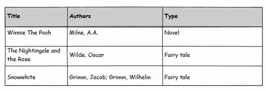

A toy example: assume that this is a mockup of the UI I want to achieve. example for a UI view

I tend towards using the second option, because I would need one less join when showing data on the screen. (I don't want to get rid of the lookup table entirely because I want to be able to restrict the values users may enter, for example by giving them a drop-down list bound to the lookup table). The only disadvantage I can think of is that, when a stakeholder says "but I want my UI to say 'story', not 'fairy tale'", I would have to update all data rows in the LiteraryWork table. I can live with this, as I don't expect it to happen often in my case.
Does the first design have any other advantages I am missing? Which of the two options is considered best practice, and why?
