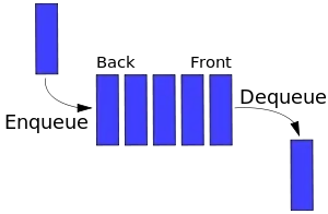

The common approach, as Ozz already mentioned, is a message queue. From a design perspective a message queue is essentially a FIFO queue, which is a rather fundamental data type:
FIFO queue
What makes a message queue special is that while your application is responsible for en-queueing, a different process would be responsible for de-queueing. In queueing lingo, your application is the sender of the message(s), and the de-queueing process is the receiver. The obvious advantage is that the whole process is asynchronous, the receiver works independently of the sender, as long as there are messages to process. The obvious disadvantage is that you need an extra component, the sender, for the whole thing to work.
Since your architecture now relies on two components exchanging messages, you can use the fancy term inter-process communication for it.
