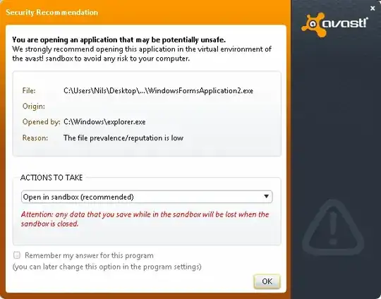

I'm creating a piece of software, that will run on windows and will act like launcher for the game, to serve as an auto-updater and file verifier in client side PC.
One thing I don't understand, why my antivirus software (Avast) is considering my exe file as dangerous and won't start it without asking to put it into sandbox, for safe use.
Is there any rules that my software should obey, to be treated as good, or should I pay hundreds of dollars for some sort of digital signing and other stuff?
I'm using C# with MS Visual Studio 2010.
VirusTotal report. No DLL injections, working as remote file downloader, using WebClient() class.
It is not like it warns about virus, but it "suggests" to sandbox it. Look at screenshot:enter image description here

  • "File prevalence/reputation is low". That message should've been in your question from the start. – Jan Doggen Mar 18 '13 at 12:30

"File prevalence/reputation is low" means Avast uses a reputation system based on the usage of the program. Only if your program has been installed and 'marked as benevolent' by enough users will it develop a good reputation and will this suggestion go away. Avast calls this the FileRep cloud feature and says "All new unknown files are potentially dangerous. Whenever they have become widespread, there will not be a reason to AutoSandbox them anymore". This is a PITA for small software companies (and Avast is not the only one doing this, note e.g. Symantec's Suspicious Insight"). One thing Avast suggests is "you can accelerate the process if you digitally sign the files."
Locally (on your computer) you can go to autosandbox expert settings and disable autosandboxing files with a low reputation, or maybe use a self-signed certificate, but that won't help you with your end users. For those I suggest you do use a real certificate (costs money, but Windows likes it too), and update your documentation with this info.
