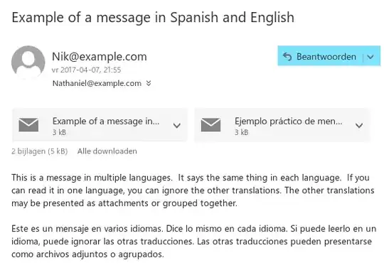

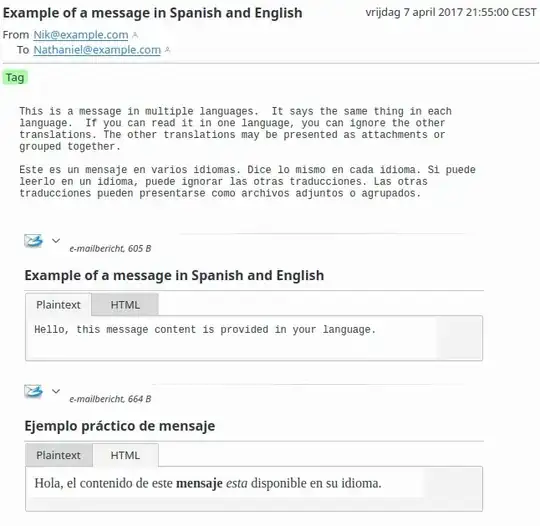

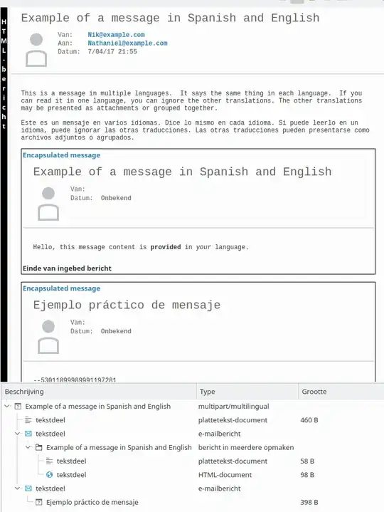

This results for some clients I tested follows below; they are not terribly encouraging. But first I'd like to note that for all these clients, when a ‘message’ attachment is opened, they do more-or-less the right thing. (One problem being with this example that the Date, From, and To headers are missing in the encapsulated messages. That can be fixed by the sender.)
  • Trojitá (decent):
  • KMail (cannot deal with more than one multipart/alternative?):
  • Outlook Web Access (ignores the inline directive…):
