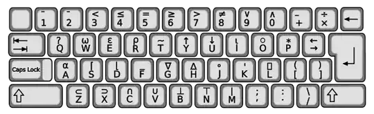

Square braces [] are easier to type, ever since IBM 2741 terminal that was "widely used on Multics" OS, which in turn had Dennis Ritchie, one of C language creators as dev team member.
http://upload.wikimedia.org/wikipedia/commons/thumb/9/9f/APL-keybd2.svg/600px-APL-keybd2.svg.png
Note the absence of curly braces at IBM 2741 layout!
In C, square braces are "taken" as these are used for arrays and pointers. If language designers expected arrays and pointers to be more important / used more frequently than code blocks (which sounds like a reasonable assumption at their side, more on historic context of coding style below), that would mean curly braces would go to "less important" syntax.

    @gnat: Square braces are easier to type on modern keyboards, does this apply to the keyboards that were around when unix and c were first being implemented? I have no reason to suspect that they were using the same keyboard, or that they would assume that other keyboards would be like their keyboards, or that they would have thought typing speed would be worth optimizing by one character. – Michael Shaw Feb 26 '13 at 15:22

  • @MichaelShaw square brackets were easier to type back then as well (answer expanded with note on IBM 2741 terminal) – gnat Feb 26 '13 at 18:29

  • @MichaelShaw your note about square brackets contradicts to what I see in the article referred to in my answer ("The Development of the C Language" by Ritchie). Article says that original notation (in BCPL) was different, `V!i` and that it was changed to `V[i]` only in B language - to me that's not quite "how people referred to arrays already anyway" – gnat Feb 28 '13 at 15:51
  • @gnat: Algol 60 and Algol 68 used square brackets, so did Pascal (which came out about the same time as C), and so (as you note) did B. PL/1 and FORTRAN didn't, using parentheses instead, but they also use parentheses for other things, with obvious problems for humans and compilers reading the code. As you noted, B immediately preceded C and used square brackets; I don't see any contradiction. – Michael Shaw Mar 01 '13 at 01:12
  • On many older teletype/terminal keyboards which didn't use a character-translation ROM, braces were regarded as "lowercase" brackets [often, the capslock key would map characters 0x60-0x7F to 0x40-0x5F; the shift key would map 0x20-0x2F to 0x30-0x3F, 0x30-0x3F to 0x20-0x2F, and 0x60-0x7F to 0x40-0x5F]. – supercat Mar 26 '15 at 15:14
