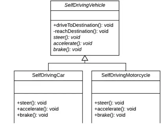

Invariant - Template of SelfDrivingVehicle which remain unchanged in all subtypes i.e. Order in which it executes the overridden behaviors to reach to destination.
Lets Assume one more method Here
           -List<SelfDrivingVehicle> vehicles
           +Add(SelfDrivingVehicle vehicle)
            vehicles.add(vehicle)
Precondition - SelfDriveVehicle the Base Type has no vehicles in it(here the context is Add) and its in Weakened Precondition which can't be altered by any of its sub types by changing the property vehicles and Strengthen it Explicitly. Any of the sub types may only invoke Add.
Postcondition - Once Add is invoked Base Type is in Strengthened Postcondition which can't be weakened by sub types by altering the value of vehicles.
State of Base Type comes back to its Original State once the Add Behavior is invoked.
