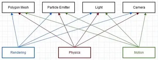

1980s Brute Force Architecture
The first architecture I worked on in the VFX industry had a long legacy that was already going past a decade since I joined the company. It was brute force crude C coding all the way (not a slant on C, as I love C, but the way it was being used here was really crude). A miniature and oversimplistic slice resembled dependencies like this:
And this is an enormously simplified diagram of one tiny piece of the system. Each of these clients in the diagram ("Rendering", "Physics", "Motion") would get some "generic" object through which they would check a type field, like so:

Of course with significantly uglier and more complex code than this. Often additional functions would be called from these switch cases which would recursively do the switch again and again and again. This diagram and code might almost look like ECS-lite, but there was no strong entity-component distinction ("is this object a camera?", not "does this object provide motion?"), and no formalization of "system" (just a bunch of nested functions going all over the place and mixing up responsibilities). In that case, just about everything was complicated, any function was a potential for a disaster waiting to happen.
Our testing procedure here often had to check things like meshes separate from other types of items, even if the identical thing was happening to both, since the brute force nature of the coding here (often accompanied by a lot of copy and paste) often made it very probable that what is otherwise the exact same logic could fail from one item type to the next. Trying to extend the system to handle new types of items was pretty hopeless, even though there was a strongly-expressed user-end need, as it was too difficult when we were struggling so much just to handle the existing types of items.
Some pros:
  • Uhh... doesn't take any engineering experience, I guess? This system does not require any knowledge of even basic concepts like polymorphism, it's totally brute force, so I guess even a beginner might be able to understand some of the code even if a pro at debugging can barely maintain it.
Some cons:
  • Maintenance nightmare. Our marketing team actually felt the need to boast the we fixed over 2000 unique bugs in one 3-year cycle. To me that's something to be embarrassed about that we had so many bugs in the first place, and that process probably still only fixed around 10% of the bugs total which were growing in number all the time.
  • About the most inflexible solution possible.

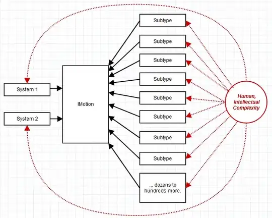

Some cons:
  • Lots of boilerplate. Our components had to be published through a registry in order to instantiate objects, the interfaces they supported required both inheriting ("implementing" in Java) the interface and providing some code to indicate which interfaces were available in a query.
  • Promoted duplicated logic all over the place as a result of the pure interfaces. For example, all components that implemented IMotion would always have the exact same state and exact same implementation for all of the functions. To mitigate this, we'd start centralizing base classes and helper functionality throughout the system for the things that would tend to be redundantly implemented the same way for the same interface, and possibly with multiple inheritance going on behind the hood, but it was pretty messy under the hood even though the client code had it easy.
  • Inefficiency: vtune sessions often showed the basic QueryInterface function almost always showing up as a middle to upper hotspot, and occasionally even the #1 hotspot. To mitigate that, we'd do things like have rendering parts of the codebase cache a list of objects already known to support IRenderable, but that significantly escalated the complexity and maintenance costs. Likewise, this was more difficult to measure but we noticed some definite slowdowns compared to the C-style coding we were doing before when every single interface required a dynamic dispatch. Things like branch mispredictions and optimization barriers are difficult to measure outside a little facet of code, but the users were just generally noticing the responsiveness of the user interface and things like that getting worse by comparing previous and newer versions of the software side-by-side for areas where the algorithmic complexity didn't change, only the constants.
  • Was still difficult to reason about correctness at a broader system level. Even though it was significantly easier than the previous approach, it was still hard to grasp the complex interactions between objects throughout this system, especially with some of the optimizations that started to become necessary against it.
  • We had trouble getting our interfaces correct. Even though there might only be one broad place in the system that uses an interface, user-end requirements would change over versions, and we would end up having to do cascading changes to all classes that implement the interface to accommodate a new function added to the interface, e.g., unless there was some abstract base class that was already centralizing the logic under the hood (some of these would manifest in the middle of these cascading changes in hopes of not repeatedly doing this again and again).

One of the the things we were noticing before (or at least I was) that was causing issues was that IMotion might be implemented by 100 different classes but with the exact same implementation and state associated. Furthermore, it would only be used by a handful of systems like rendering, keyframed motion, and physics.
So in such a case, we might have like a 3-to-1 relationship between the systems using the interface to the interface, and a 100-to-1 relationship between the subtypes implementing the interface to the interface.
The complexity and maintenance then would be drastically skewed to the implementation and maintenance of 100 subtypes, instead of 3 client systems who depend on IMotion. This shifted all of our maintenance difficulties to the maintenance of these 100 subtypes, not the 3 places using the interface. Updating 3 places in the code with few or no "indirect efferent couplings" (as in dependencies to it but indirectly through an interface, not a direct dependency), no big deal: updating 100 subtype places with a boatload of "indirect efferent couplings", pretty big deal *.
* I realize it's odd and wrong to screw with the definition of "efferent couplings" in this sense from an implementation perspective, I just haven't found a better way to describe the maintenance complexity associated when both interface and corresponding implementations of a hundred subtypes must change.

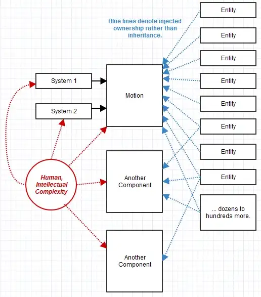

What I noticed with the ECS approach was that it solved the problems I was still struggling with above. Most importantly to me, it felt like we were managing healthy-sized "cities" instead of teeny little villages with complex interactions. It wasn't as hard to maintain as a monolithic "megalopolis", too big in its population to effectively manage, but wasn't as chaotic as a world filled with tiny little villages interacting with each other where just thinking about the trade routes in between them formed a nightmarish graph. ECS distilled all the complexity towards bulky "systems", like a rendering system, a healthy-sized "city" but not an "overpopulated megalopolis".
Components becoming raw data felt really weird to me at first, as it breaks even the basic information hiding principle of OOP. It was kind of challenging one of the biggest values I held dear about OOP, which was its ability to maintain invariants which required encapsulation and information hiding. But it started to become a non-concern as it quickly became obvious what was happening with just a dozen or so broad systems transforming that data instead of such logic being dispersed across hundreds to thousands of subtypes implementing a combo of interfaces. I tend to think of it like still in an OOP-style fashion except spread out where the systems are providing the functionality and implementation that access the data, the components are providing the data, and the entities are providing components.
It became even easier, counter-intuitively, to reason about the side effects caused by the system when there were just a handful of bulky systems transforming the data in broad passes. The system became a lot "flatter", my call stacks became shallower than ever before for each thread. I could think about the system at that overseer level and not run into weird surprises.
Likewise, it made even the performance-critical areas simple with respect to eliminating those queries. Since the idea of "System" became very formalized, a system could subscribe to the components it was interested in, and just be handed a cached list of entities which satisfy that criteria. Each individual one didn't have to manage that caching optimization, it became centralized to a single place.

  • Seems to just solve almost every major architectural problem I was encountering in my career without ever feeling trapped in a design corner when encountering unanticipated needs.
Some cons:
  • I still have a hard time wrapping my head around it sometimes, and it's not the most mature or well-established paradigm even within the game industry, where people argue about exactly what it means and how to do things. It's definitely not something I could have done with the former team I worked with, which consisted of members deeply hooked to the COM-style mindset or the 1980s C-style mindset of the original codebase. Where I get confused sometimes is like how to model graph-style relationships between components, but I've always found a solution which didn't turn out to be horrible later where I can just make a component dependent upon another one ("this motion component depends on this other one as a parent, and the system will use memoization to avoid repeatedly doing the same recursive motion calculations", e.g.)
  • ABI is still difficult, but so far I'd even venture to say that it's easier than pure interface approach. It's a shift in mindset: data stability becomes the sole focus for ABI, rather than interface stability, and in some ways it's easier to achieve data stability than interface stability (ex: no temptations to change a function just because it needs a new parameter. That kind of stuff happens inside coarse system implementations which don't break ABI).
