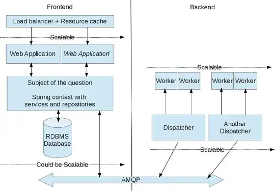

I'm currently working on a project that need to be dynamically scaled on demand according to the need.
My question is about scaling spring context. My web application has a classical multi module core (service, persistence, domain), which use use by client application (webapp, api).
The user end application could be clustered, database too, but I don't know how to proceed with spring context.
I plan to use Scala Akka actors on Spring service, but I can't be persuaded by the solution of using one context exposed by actors. All of the rest of the application is built with event driven techniques (Spring events are produced by the service layer).
I already built different webapps by user profile to scale according to user role (Eg. admin, enduser), however the only thing is Spring Context for business operations.
Question: Do I have to merge in one single context shared by all client applications or should I initialize one context per application?
https://i.stack.imgur.com/0ysv7.png

  • Hi Zenithar, I feel this is a good question, however your thoughts seem a bit scattered. It is hard to understand what your question is and how the following diagram demonstrates a scalability problem. – maple_shaft Feb 11 '13 at 15:19
  • Thanks, you have extracted the real question ! The diagram shows all scallable vectors, marked as a black dotted arrow. Only spring context does not have a scallable vector, because i don't know how to scale it ! – Zenithar Feb 11 '13 at 15:38

Its kinda hard to understand your diagrams, like is the front end section on the left part is the whole client application architecture?? and the right section is the server side? even though, it is, still I can't get to understand why you have the database and spring layer in the front end?is it a database uniquely local to each client application?
But to give my idea, the common trend in using Spring application context is making it as singleton meaning one spring context in the server side,thats the essence of it, or else you have already defy its purpose. The beans (e.g services) should be stateless so not to produce undesirable result that concurrency issues could results from more than one client requesting the same thing and would need to use the same beans/services. making them singleton of course is the ideal way to save memory and avoid the instance creation on demand and after using is just to be garbage collected. There will be no bottleneck but instead it would be actually faster cause the object is already loaded in the memory and each request will have its own heap when executing that object once called. So basically, singleton is faster and saves more memory.

  • It's not a "ui" frontend, but a frontend service. Clearly it's 2 distinct java process, frontend is an application server, and backend in a osgi container (apache karaf). – Zenithar Feb 22 '13 at 22:48
