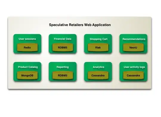

Moreover, there's a good article from Martin Fowler on the subject. He's made a nice diagram that I really like:
Go check out his pages to read some deep thoughts about NoSQL.
