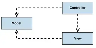

MVC
It is important to note that both the view and the controller depend on the model. However, the model depends on neither the view nor the controller. This is one the key benefits of the separation. This separation allows the model to be built and tested independent of the visual presentation. The separation between view and controller is secondary in many rich-client applications, and, in fact, many user interface frameworks implement the roles as one object. In Web applications, on the other hand, the separation between view (the browser) and controller (the server-side components handling the HTTP request) is very well defined.
Model-View-Controller is a fundamental design pattern for the separation of user interface logic from business logic. Unfortunately, the popularity of the pattern has resulted in a number of faulty descriptions. In particular, the term "controller" has been used to mean different things in different contexts. Fortunately, the advent of Web applications has helped resolve some of the ambiguity because the separation between the view and the controller is so apparent.

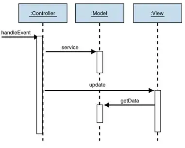

In Application Programming in Smalltalk-80: How to use Model-View-Controller (MVC) [Burbeck92], Steve Burbeck describes two variations of MVC: a passive model and an active model.
The passive model is employed when one controller manipulates the model exclusively. The controller modifies the model and then informs the view that the model has changed and should be refreshed (see Figure 2). The model in this scenario is completely independent of the view and the controller, which means that there is no means for the model to report changes in its state. The HTTP protocol is an example of this. There is no simple way in the browser to get asynchronous updates from the server. The browser displays the view and responds to user input, but it does not detect changes in the data on the server. Only when the user explicitly requests a refresh is the server interrogated for changes.
MVC - Passive Model
I'm not in a position to say which of the opinions is "right", and to be honest, I am a bit more confused after reading the answers here and the linked article.
Full text of article here.
