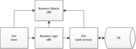

We are about to write our first WPF application and are becoming familiar with the MVVM pattern. We've built many Winform applications and have an architecture that has been very successful for us. We're having a little bit of trouble translating that architecture or determining where certain pieces of our architecture fit in the MVVM model.
Historically we have a Gui (the main exe) that then communicates to a BusinessLogic dll. The BusinessLogic communicates to a DAL dll through a web service and the DAL interacts with the DB. The DAL, BusinessLogic and GUI all reference the same BusinessObjects dll.
AsIs Architecture
Some of the transition to MVVM is fairly straight forward. Our Gui will still contain the views, our BusinessOjbects will still contain the model and our DAL will still interact with the DB (although the technology to implement them may change).
What we're not sure of is our BusinessLogic component. Historically this would provide functions for the GUI to call to then populate controls in the views (ie. GetCustomerList which would return a list of Customer objects or the typical CRUD functions).
The main hang up we have is whether the MVVM pattern would call for an additional component to house the ViewModels or if we just change our thinking and migrate what we have used as our BusinessLogic component to the ViewModels?
Does our BusinessLogic component represent the ViewModels?

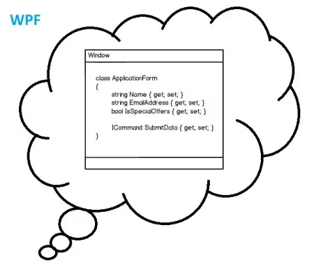

You are correct that you would essentially be replacing your BusinessLogic dll with your ViewModel layer, however I think the biggest difference you will face is how the View/UI layer interacts with your ViewModel/BusinessLogic layer.
In WinForms, the GUI is your application, and is responsible for application flow. In WPF/MVVM, your ViewModels are you application, and the GUI becomes just a user-friendly interface to interact with the ViewModels.
For example, with WinForms, you might have a DataGrid and a Button, and when you click that Button you call BusinessLogicLayer.GetProducts() and load the resulting Product objects into the DataGrid.
With WPF, you would have a ViewModel that contains an ObservableCollection<Products> and an ICommand GetProducts, and executing the command calls the DAL and loads the collection of products. But to provide a user-friendly interface for this, you would create a View which renders your ViewModel using a DataGrid for the Products collection, and a Button for the GetProducts command.
I actually wrote a fairly recent post for my blog about the change in mindset when moving from Winforms to WPF on my blog, and I think the best way to summarize the difference is with these pictures:
