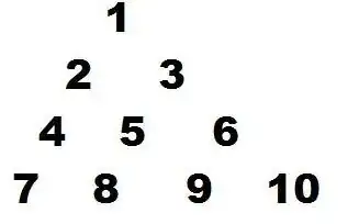

Empty glasses of water are arranged in the following order:
When you pour liquid into the 1st glass if it's full, then the extra liquid would be flown into the glasses 2 and 3 in equal quantities. When glass 2 is full, the extra liquid would be flown into 4 and 5 and so on.
Given an N liters of liquid and maximum capacity of each glass is 1 liter, give the amount of liquid present in any glass if you empty N liters of liquid by pouring into glass by filling out the function getWaterInBucket(int N, int X) where X is the glass number. So for example if I want have 4 liters at the beginning and I want to find the water in glass 3 the function is getWaterInBucket(4, 3)
How do I solve this programmatically? I tried to find a math solution using Pascal's triangle. This did not work. I considered it to be a tree so I can add a parameter like this getWaterInBucket(BTree root, int N, int X) and then try some recursive solution for each level, but parameters are not allowed in this problem. Is there something obvious, some trick?

  • Can you ever pour into a glass other than glass 1? If not, each tier will have equal amounts of water in each glass. Thus, you will have full tiers whenever you pour 1, 3, 6, 10 ... liters. If you pour 7 litres, then the fourth row has 4 glasses so each will be 1/4 full. All the tiers above it will be full. – GlenPeterson Jan 28 '13 at 13:30
    @GlenPeterson From how I'm reading it I don't think they would fill equally. Yes, 2 & 3 would fill equally because they only have one thing pouring into them but once they are full 2 pours equally into 4/5 and 3 pours equally into 5/6, thus 5 gets filled at twice the rat of 4/6. The center cups are always filling faster than the outer cups. by the time 4/6 are full 8/9 are 25% full and 7/10 are still empty. – Brad Jan 28 '13 at 14:20
    Also, this reminds me of Pascal's Triangle.. – Brad Jan 28 '13 at 15:03
  • @mouviciel Haha GlenPeterson - The first glass to be poured is always glass 1 . The interviewer also said to use this information. He seemed more confused than I was about the right answer to this problem. – Vrashabh Irde Jan 28 '13 at 16:05

  • @Kiewic left and right glasses are easy to find. the top glass is at "level 0", 1 and 2 are at level 1 and so on. If you want to know who are the left and right glasses corresponding to, let's say, 3 (level 1, I know this by performing integral division by two), you just have to do this formula: (3 + level + 1, 3 + level + 2) = (5, 6) On the other hand, time here is a factor so, in order for this simulation to be closer to reality, the recursive steps might need to be done in parallel (so that the filling of left and right happen at the same time) – Clint Eastwood Feb 24 '14 at 16:42
Here's how I would answer this question in an interview situation (I haven't seen this question before, and I didn't look at the other answers until I had my solution):
First, I tried to just figure it out (which you called the "math solution") and when I got to glass 8 I realized that it would be tougher than it seemed because glass 5 starts to overflow before glass 4. At that point I decided to go down the recursion route (just an FYI, a lot of programming interview questions require recursion or induction to solve).
Thinking recursively, the problem becomes much easier: How much water is in glass 8? Half of the amount that has spilled out of glasses 4 and 5 (until it is full). Of course, that means we have to answer how much has spilled out of glasses 4 and 5, but it turns out that's not too hard either. How much has spilled out of glass 5? Half of however much spilled out of glasses 2 and 3, minus the liter that stayed in glass 5.

Thinking about this as a tree problem is a red-herring, it's really a directed graph. But forget all about that.
Think of a glass anywhere below the top one. It will have one or two glasses above it that can overflow into it. With the appropriate choice of coordinate system (don't worry, see the end) we can write a function to get the "parent" glasses for any given glass.
Now we can think about an algorithm to get the amount of liquid poured into a glass, irrespective of overflow from that glass. The answer is however much liquid is poured into each parent minus the amount stored in each parent glass, divided by 2. Just sum that for all parents. Writing this as a python fragment of the body of an amount_poured_into() function:

This is the binomial function. The ratio of the water between the glasses of level N can be discovered using nCr for each glass in the level. In addition, the total number of glasses prior to level N is the sum of 1 to (N - 1), a formula for which you should be able to find available fairly easily. Thus, given X, you should be able to determine it's level, and use nCr to check the ratios of the glasses for that level, and thus determine how much water is in X, if there are enough liters to go down to X anyway.
Secondly, your idea of using the BTree is fine, it's just that the BTree is an internal variable, not an external parameter.
IOW, if you've covered this mathematics in your education (here in the UK it's taught prior to university) then you should be able to solve this without too much problem.
