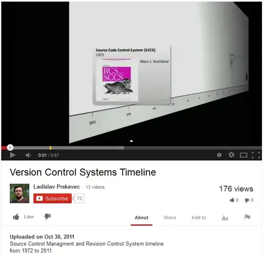

Here is a pretty decent timeline of the major players in video form (no sound).
It suggests that SCCS was first, by a margin of about 9 years.
https://i.stack.imgur.com/wcAWD.png
There is a lot missing off there though, as evidenced by this blog and the resulting comments.

    The [original paper on SCCS](http://basepath.com/aup/talks/SCCS-Slideshow.pdf) mentions no other systems, and seems to indicate that it had to come up with terminology itself. From that source alone it looks as if there was no version control system before 1972/73. – Martijn Pieters Jan 24 '13 at 18:12
    Naming a source code control system "Source Code Control System" is indeed indication that it was the first instance of something that would become a software category later. – Ingo Jan 24 '13 at 21:57
  • @MartijnPieters Rochkind acknowledges Brown's CLEAR at the end of the paper, and simply put, building SCCS on OS/MVT, he could not have been unaware of IEBUPDTE. – Ross Patterson Dec 31 '18 at 15:51
  • @RossPatterson: neither CLEAR nor IEBUPDTE are source control systems. CLEAR is credited for the idea of deltas, it explicitly states in the paper that there are no other similarities. – Martijn Pieters Dec 31 '18 at 17:16
