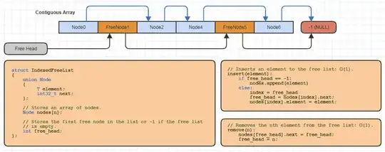

For example, I've probably implemented this basic "indexed free list" data structure a dozen times over in C locally for each site that uses this allocation strategy (almost all my linked structures to avoid allocating one node at a time and halve the memory costs of the links on 64-bit):
But in C it just takes a very small amount of code to realloc a growable array and pool some memory from it using an indexed approach to a free list when implementing a new data structure which uses this one.
Now I have the same thing implemented in C++ and there I only have it implemented once as a class template. But it's a much, much more complex implementation on the C++ side with hundreds of lines of code and some external dependencies which also span hundreds of lines of code. And the main reason it's much more complicated is because I have to code it against the idea that T could be any possible data type. It could throw at any given time (except when destroying it, which I have to do explicitly as with the standard library containers), I had to think about proper alignment to allocate memory for T (though fortunately this is made easier in C++11 onwards), it could be non-trivially constructible/destructible (requiring placement new and manual dtor invocations), I have to add methods that not everything will need but some things will need, and I have to add iterators, both mutable and read-only (const) iterators, and so on and so forth.
