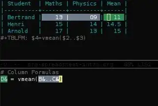

This may not fit your needs, but may fit another's. Org-mode for Emacs includes table.el, which, along with Org-mode's particular enhancements, provides an extremely robust solution for spreadsheets, all in plain text. More information (much more than the scope of this site) is available at Org-mode's website and manual, particularly its spreadsheet tutorial.
