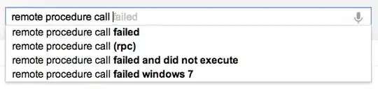

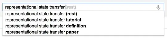

Just to dramatize it a bit, some Google Instant results for RPC vs REST:
RPC
REST
miku
  • 1,508
  • 26
27
