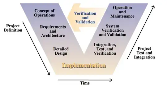

Where I am getting this from is from the approach to Systems Engineering called the "design V" (sometimes the design W). See Wikipedia for more, though in an "Agile" world some of this gets forgotten.
