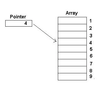

I found that diagrams were very helpful. Example:
pointer diagram
This sort of diagram helped me see that pointers were their own variable, but contained a value that was the location of another object, i.e. array or string. Also, when done in pencil, I could use it to trace my program on paper, or on a chalkboard/whiteboard.

    Either the value within "pointer" should be 4 or the array indices (or memory addresses) should start from 0. Otherwise, how can a pointer that holds the value 3 point to location 4? – MAK Nov 09 '10 at 19:43

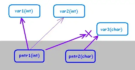

I shall assume someone going to learn pointers knows what the normal variables are and how they work in C. Now, let's try to define pointers with some of it's attributes-
  • They are also variables, but of different nature. Assume there are two layers in the variable space. The normal variables of different types resides in the upper layer and pointers in the lower layer. Like this figure-
    alt text
  • As the name 'Pointer' suggests, pointers can POINT to something. Like our finger can point to some object. What are the things they point to? These are the normal variables. In short, "Pointers point to normal variables".
  • Like normal variables, pointers also are of same number of types like int,char or float. And a pointer of a specific type can point to only same type of variables.
  • A pointer can point to one variable and later the same pointer can point to another variable. Just the type should be same. So, the a pointer's association with some variable is not permanent and can be changed.
  • So, how a pointer is declared? Almost like normal variables. You have to precede the name with an asterisk(*). Like-
    int *pointer;
  • Then, how a pointer is associated with a variable? Using the & operator before the variable like this statement-
    pointer = &variable;
  • How a pointer is used by pointing to a variable? This is also done by preceding the name with an asterisk(*). Then it can be used in the place of the variable it's pointing now-
    *pointer = var1 + var2;

  1. Pointer can be thought of as a generalization of an index into an array.
    • Consider that a big array can be chopped off into a number of smaller, non-overlapping, variable-sized arrays. Now, these smaller arrays are what we usually think of as array. The bigger one is then the computer's entire memory space. The process of chopping off smaller arrays is called memory allocation.
  2. A set of structures which are linked together by some pointers can be thought of as a directed graph.
    • Each vertex is a variable which can hold some value.
    • Some variables are pointers, and each pointer can have exactly one outgoing edge into something else.
    • Variables which are not pointers will not have any outgoing edge. They could have any number of incoming edge.

When I was in university, my professor had some really neat powerpoint slides depicting a point as a separate variable on it's own with an arrow to a memory location (represented like an array) and when we were doing Linked Lists, he would do it step-by-step, showing when the arrow changes, when the pointer is dereferenced etc..., there was no way one could not understand it within a couple of minutes. The concept itself is really easy, but doing it right or applying it in practical programs requires more practice.
chiurox
  • 1,498

Assuming you already understand arrays at least at a superficial level, my best explanation for pointers would be this:
Imagine all of the memory in your computer (or address space in your process if you want to be more precise) as one giant array of bytes. A pointer is just an index into that array. Pointers are therefore just a special kind of integer.
Learning about all the tricks that C and assembly coders could do by treating pointers as integers, and how the distinction is purely convention at the assembly language level, helped solidify this understanding for me.
dsimcha
