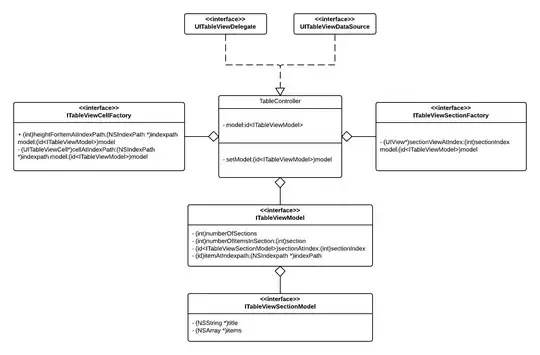

I have recently wrote an article about how to implement delegates and data sources for UITableView: http://gosuwachu.gitlab.io/2014/01/12/uitableview-controller/
The main idea is to split responsibilities into separate classes, like cell factory, section factory, and provide some generic interface for the model that UITableView is going to display. Diagram below explains it all:
