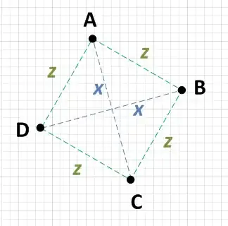

Assuming that your square might be rotated against whatever coordinates system you have in place, you can't rely on there being any repetition of X and Y values in your four points.
What you can do is calculate the distances between each of the four points. If you find the following to be true, you have a square:
  1. There are two points, say A and C which are distance x from each other, and two other points, say B and D which are also distance x from each other.
  2. Each point {A, B, C, D} is an equal distance from the two points which aren't x away. i.e.: If A is x away from C, then it will be z away from both B and D.
Incidentally, the distance z will have to be SQRT((x^2)/2), but you don't need to confirm this. If conditions 1 and 2 are true then you have a square. NOTE: Some people are concerned about the inefficiency of square root. I didn't say that you should do this calculation, I just said that if you did you would get a predictable result!
Illustration of Square Rules
The bare minimum of work that you would need to do would be to pick a point, say A and calculate the distance to each of the other three points. If you can find that A is x from one point and z from two other points, then you just need to check those two other points against each other. If they are also x from each other then you have a square. i.e.:
  • AB = z
  • AC = x
  • AD = z
Since AB = AD, check BD:
  • BD = x
Just to be sure, you need to check the other sides: BC and CD.
  • BC = z
  • CD = z
Since AC = BD and since AB = AD = BC = CD, this is therefore a square.
Along the way, if you find more than two distinct edge distances then the figure cannot be a square, so you can stop looking.
Working Example Implementation
I have created a working example on jsfiddle (see here). In my explanation of the algorithm, I use arbitrary points A, B, C, and D. Those arbitrary points happen to be in a certain order for the sake of walking through the example. The algorithm works even if the points are in a different order, however, the example doesn't necessarily work if those points are in a different order.
Thanks to: meshuai, Blrfl, MSalters and Bart van Ingen Schenau for useful comments to improve this answer.

    You can short-circuit this process and not worry about how the points are ordered by measuring the distance between them and keeping track of the number of unique distances you find. Once you exceed two (Joel's _x_ and _z_), the figure isn't a square. – Blrfl Nov 23 '12 at 13:36
    the bare min, I don't think it works. At last, you say "it doesn't matter which one, either BC or CD". But if I just check one of them, the figure perhaps is a special Parallelogram. – MarshalSHI Nov 23 '12 at 13:46
  • @Blrfl - Yes, the order is irrelevant. I used ordered points to make the description clearer, but there is nothing in the algorithm that relies on ordering. I think the _shortest circuit_ is five point to point measurements. – Joel Brown Nov 23 '12 at 13:46
    @meshuai - If the diagonals are equal it can't be a parallelogram. – Joel Brown Nov 23 '12 at 13:47
  • If we use the algorithm above the pic, it can help us to get the answer. But we have to calculate all edges. – MarshalSHI Nov 23 '12 at 13:49
  • yeah, I mean we have to check both BC and CD. – MarshalSHI Nov 23 '12 at 13:50
  • @meshuai - If you like you can check both BC and CD, but once you know AB = AD = BC (plus AC = BD) then there is nowhere else for CD to go. It has to be the same as the other sides. – Joel Brown Nov 23 '12 at 13:52
    @Joel Brown . no, if triangle ABC and ABD are Isosceles triangle, which the angle ABC in triangle ABC and angle BAD in triangle ABD are right angle. If C and D are in different side of line AB, that will be a special parallelogram. So, we need check both. – MarshalSHI Nov 23 '12 at 13:59
    Another optimisation would be to compare the squared distances, instead of the distances. – vaughandroid Nov 23 '12 at 14:03
  • @meshuai - I've been woodworking long enough to know that if angle ABC = angle BAD and segment AB equals segment CD then ABC = BAD = 90 degrees, but feel free to cross check as much as you like. – Joel Brown Nov 23 '12 at 14:17
    @Blrfl: Your test doesn't work. Let ABCD be a diamond with AB=BC=CD=DA=1, AC=1 too (short diagonal), then AD~1.7 (long diagonal)/ You have only two lengths x and z, yet the figure is not a square. – MSalters Nov 23 '12 at 14:23
  • like MSalters said. SO, we need check all edges. @JoelBrown – MarshalSHI Nov 23 '12 at 14:37
    @JoelBrown: It is possible to create a trapezium shape with the diagonals AC = BD = x, the sides AB = BC = AD = z and the last side CD = y != z. – Bart van Ingen Schenau Nov 23 '12 at 14:38
  • @MSalters: If you get to the point where there are more than two unique distances, you can conclusively say the figure isn't a square and bail out early. Whether that optimization is worth doing depends on the expense of doing all of the other math. – Blrfl Nov 23 '12 at 14:40
  • The `SQRT((x^2)/2)` condition needs to be checked in 3+ dimensions. Else you can take a square, raise the corners along one diagonal, and your test passes but it is no longer a square. – btilly Nov 23 '12 at 19:55
    Fair enough, note however that OP said explicitly 2 dimensions. – Joel Brown Nov 23 '12 at 21:03
  • You HAVE to check CB and CD, it's not "just to be sure": If you put A, B, D on a square and draw a circle with center A and radius _x_, C could be anywhere on the circle and all the other tests will pass. (Checking _one_ of CB, CD narrows it down to two points, so you need both). – alexis Nov 23 '12 at 23:22
  • This algorithm fails on these 4 points: A=(4,6), B=(5,5), C=(5,6), D=(4,5). It only seems to work if the points are in that particular order, and if you swap B and C around it returns false when it should return true. – Contango Jul 16 '13 at 12:54
  • @Gravitas - You didn't read the algorithm, you just followed the example having redefined the points. Read the algorithm again. Pick a point and test the distance to each other point. Picking A: AC=1, AB=SQRT(2), AD=1. Since AC=AD, and AB != AC, AD -> look at CD, which is=SQRT(2). Since AB=CD, check CB and BD, which both = 1 (= AC, AD) so it's a square. – Joel Brown Jul 16 '13 at 21:55
  • @Joel Brown Yes, the algorithm works perfectly if the points are in that order. However, if I want to check if 4 random points form a square, this algorithm will only work if they are presented in that order. – Contango Jul 18 '13 at 08:04
    @Gravitas - Please see my edit, including a link to a jsfiddle that shows that the algorithm works with your points. – Joel Brown Jul 18 '13 at 14:08
  • @Joel Brown. Nice work! I believe your answer is now perfect. – Contango Jul 19 '13 at 16:04

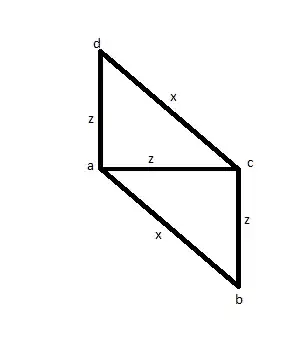

I'm sorry but some answers don't apply.
For the case you measure 3 edges (let's say AB, AC and AD) to find that two have the same size (let's say AC and AD) and one is bigger (let's say AB). Then you would measure CD to see if it's the same size of AB, and you find that it is. Instead of a square, you could have the picture below, and that makes it a wrong solution.
Not a square...
Then you try some other solution: measure all the distances at least once: AB, AC, AD, BC, BD, CD. Then you find that 4 of then are equal, and the other 2 are also equal among themselves. But you could just have a picture like below:
And that's not a square, too...
So, those answers aren't correct, despite the high upvotes they received.
One possible solution: if the two equal measures don't connect the same point. So: if AB and CD are the same lenght, all the other combinations (AC, AD, BC, BD) are also equal, you have a square. If you have the same point making the biggest length (AB and AC is the biggest, and all the others are equal), you have one of the pictures above.
woliveirajr
  • 223
  • no, his algorithm said the 2 edges of distances x do not share a point. but you just share C. So, assume A-C is x, then B-D should be another x instead of your B-C. – MarshalSHI Nov 23 '12 at 15:15
