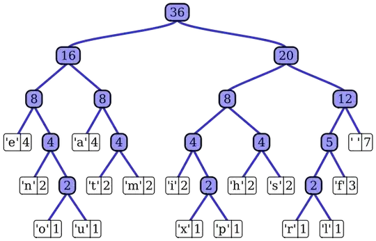

On my great quest for compressing/decompressing files with a Java implementation of Huffman coding (http://en.wikipedia.org/wiki/Huffman_coding) for a school assignment, I am now at the point of building a list of prefix codes. Such codes are used when decompressing a file. Basically, the code is made of zeroes and ones, that are used to follow a path in a Huffman tree (left or right) for, ultimately, finding a byte.
In this Wikipedia image, to reach the character m the prefix code would be 0111 enter image description here
The idea is that when you compress the file, you will basically convert all the bytes of the file into prefix codes instead (they tend to be smaller than 8 bits, so there's some gain).
So every time the character m appears in a file (which in binary is actually 1101101), it will be replaced by 0111 (if we used the tree above).
Therefore, 1101101110110111011011101101 becomes 0111011101110111 in the compressed file.

Technically, the prefix code of such byte would be... none, because there is no path to follow, right? I mean, there is only one unique byte anyway, so the tree has just one node.
Therefore, if the prefix code is none, I would not be able to write the prefix code in the compressed file, because, well, there is nothing to write.
Which brings this problem: how would I compress/decompress such file if it is impossible to write a prefix code when compressing? (using Huffman coding, due to the school assignment's rules)

However, if you still insist on using Huffman coding, you could pick either one or zero to represent the symbol in the tree. This causes no problem really. Your tree simply states that symbol x is represented by bit m. Then you have n number of repeats of the encoded m as data. You could even then apply aforementioned RLE on the actual data (which is essentially a run of equal bits of length n) to compress further.
