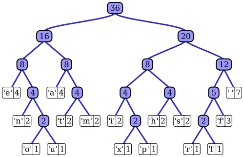

The reason I ask this is because Wikipedia has this image:

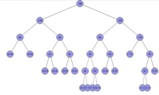

And I wanted to see if my Huffman's tree was the same. I created a file with the following content:
aaaaeeee       nnttmmiihhssfffouxprl
And this was the result:
Doesn't look so bad. But there clearly are some differences when multiple nodes have the same frequency.

  • What is Wikipedia's image doing to discriminate the nodes with the same frequency?
  • Is my tree wrong? (Is Wikipedia's image method the one and only answer?)
I guess there is one specific and strict way to do this, because for our school assignment, files that have been compressed by my program should be able to be decompressed by other classmate's programs - so there must be a "standard" or "unique" way to do it. But I'm a bit lost with that.
My code is rather straightforward. It literally just follows Wikipedia's listed steps. The way my code extracts the two nodes with the lowest frequency from the queue is to iterate all nodes and if the current node has a lower frequency than any of the two "smallest" known nodes so far, then it replaces the highest one. Just like that.
