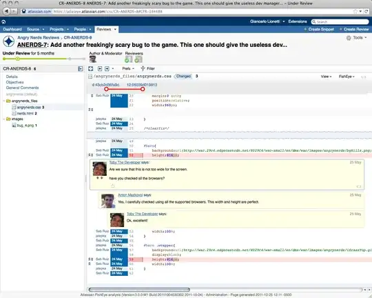

Rely on Code Review and Code Annotation Tools
It's a tricky decision to make, as sometimes you'd prefer to have everything with the code in your SCM (in fact there's even a code review tool for Eclipse that stores review comments in text files along with the source files, for instance). But for larger teams and projects it works quite well to have dedicated tools to annotate code and have extended discussions recorded somewhere, within the context of your code. You can also link them to current code-reviews, to tasks, or directly make comments on a file or a changetset.
Atlassian Crucible showing a threaded discussion in a code review.
In the screenshot above, for instance, you can see a threaded discussion directly inlined with the code to highlight a concern, and this is being done as part of a formal core review item (with the ID CR-ANERDS-8) relating to an open ticket (with the ID ANERDS-7).

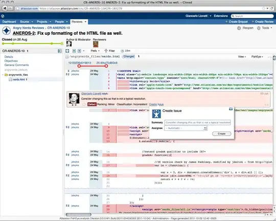

Atlassian Crucible used to open a nez JIRA ticket for a follow-up action after a review.
Here is an example of a use case where you create a new ticket to be able to track future follow-up actions on the review. The reviewer can easily create tasks as he sifts through your code and notices shady spots.
There are numerous tools for this, but personally I tend to find FishEye and Crucible above par (and obviously working great hand in hand with JIRA, or even Confluence to link to even more detailed docs if needed).
