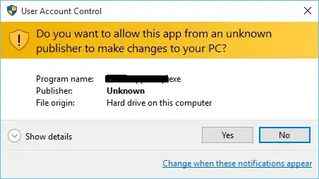

I think Code Signing Certificate is an ideal option to protect your application. Code Signing Certificates help create a sense of online confidence when users download your software by verifying the authenticity of your identity.
Without code signing user will see -
With Code Signing Certificate
You can buy a code signing certificate at cheap cost from Comodo. This article will give you a closer look about Code Signing Certificate.

This kind of error appear due to lack of digital signature or verification. A code Signing Certificate is good option to prevent such error.
Code Signing is the method in which a certificate-based digital signature is used to sign scripts and executables so that one can verify the identity of the author and make sure that the code has not been corrupted as it was signed by the author himself.
