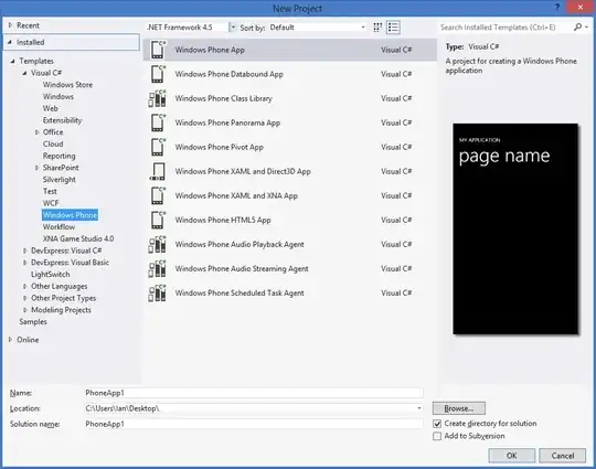

Few things I do know from this weekend:
1) You need Visual Studio 2012.
2) You need Windows 8.
This is the list of project templates you get with the Windows Phone 8 SDK installed:
VS2012 templates for WinPhone 8 development
That's from a post I made at the weekend. It's not a complete answer I know, but I'm still feeling around the edges, so I'd be glad of some more input from others too.
