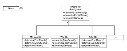

The first thing that came to my mind to design this was to use the strategy pattern, I have a variation in algorithms (the actual rules of the game). The design could look like this: enter image description here

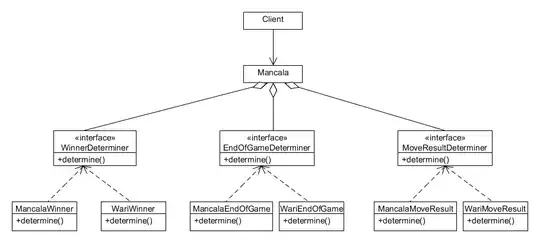

I then thought to myself that in the game of Mancala and Wari the way the winner is determined is exactly the same and the code would be duplicated. I don't think this is by definition a violation of the 'one rule, one place' or DRY principle seeing as a change in rules for Mancala wouldn't automatically mean that rule should be changed in Wari as well. Nevertheless from the feedback I got from my professor I got the impression to find a different design.
I then came up with this: enter image description here
Each game (Mancala, Wari, Kalah, ...) would just have attribute of the type of each rule's interface, i.e. WinnerDeterminer and if there's a Mancala 2.0 version which is the same as Mancala 1.0 except for how the winner is determined it can just use the Mancala versions.

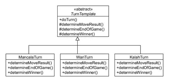

Those three last steps are all in my strategy pattern described above. I'm having a lot of trouble combining these two. One possible solution I found would be to abandon the strategy pattern and do the following: enter image description here
I don't really see the design difference between the strategy pattern and this? But I am certain I need to use a template method (although I was just as sure about having to use a strategy pattern).

After looking at your designs, both your first and third iterations appear to be more elegant designs. However, you mention that you're a student and your professor gave you some feedback. Without knowing exactly what your assignment or the purpose of the class is or more information about what your professor suggested, I would take anything I say below with a grain of salt.
In your first design, you declare your RuleInterface to be an interface that defines how to handle each player's turn, how to determine if the game is over, and how to determine a winner after the game ends. It seems like that's a valid interface to a family of games that experiences variation. However, depending on the games, you might have duplicated code. I'd agree that the flexibility to change the rules of one game is a good thing, but I'd also argue that code duplication is terrible for defects. If you copy/paste defective code between implementations and one has a bug in it, you now have multiple bugs that need to be fixed in different locations. If you rewrite the implementations at different times, you could introduce defects in different locations. Neither of those is desirable.
Your second design seems rather complex, with a deep inheritance tree. At least, it's deeper than I would expect for solving this type of problem. You're also starting to break up implementation details into other classes. Ultimately, you are modeling and implementing a game. This might be an interesting approach if you were required mix-and-match your rules for determining the results of a move, the end of the game, and a winner, that doesn't seem to be in the requirements that you've mentioned. Your games are well defined sets of rules, and I'd try to encapsulate the games as much as I can into separate entities.
Your third design is one that I like the best. My only concern is that it's not at the right level of abstraction. Right now, you appear to be modeling a turn. I would recommend considering designing the game. Consider that you have players who are making moves on some kind of board, using stones. Your game requires these actors to be present. From there, your algorithm is not doTurn() but playGame(), which goes from the initial move to the final move, after which it terminates. After every player's move, it adjusts the state of the game, determines if the game is in a final state, and if it is, determines the winner.

  • Thanks for the great advice, especially your point about the fact that it was at the wrong level of abstraction. I've changed it now to a `GameTemplate` which does feel a lot better. It also allows me to combine a factory method to initialize players, the board, etc. – Mekswoll Oct 28 '12 at 19:22
