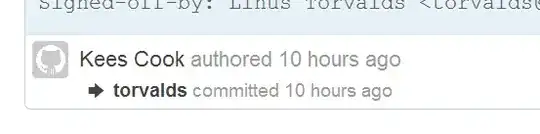

Notice the following part: enter image description here
So one authored and Torvalds committed. How is this possible. I thought that it was only possible to have either pull or pushing rights, but here it seems like there is an approval stage.

  • Kees wrote the code and Linus merged that code into the Linux repo. In this workflow Kees does not have access to the Linux repo. He can therefore only make pull requests (in a pure git workflow a pull request is an email, message, thumbdrive etc. that you give to the repo's owner that contains the git diff, gitlab allows you to send the pull request message via the gitlab website but that's gitlab acting as a messaging system, it is not part of git per se) – slebetman Feb 21 '21 at 23:51
Every git commit has separate "author" and "committer" metadata fields, which can be set manually when doing a commit, or automatically through mechanisms like pull requests in github.
This allows workflows that include sending patches via email, which is apparently still the main mechanism used for the Linux kernel - the github repository is just a mirror, and Linus does not like the implementation of github pull requests, so he will not accept them.
