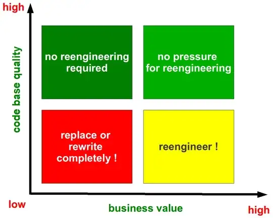

This graphic could help, it's a function of code base quality and business value of the application:
The chart pretends to be a guide on when a re-engineering of legacy software is justified and when it's not. For example, if the software has high business value and the quality of the code is poor, then a re-engineering is justified.
