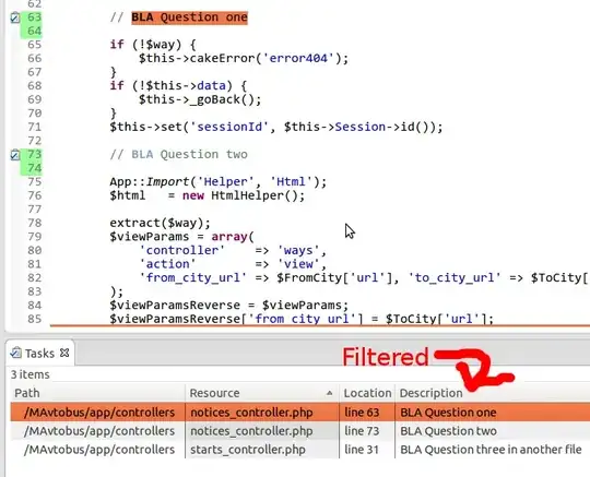

I know, that custom comment tags are possible in eclipse & netbeans. Sure it also should be in blablaStorm family.
Example of custom filtered task-from-comments in eclipse

  • You may also encounter minor issues with the syntax (which also exists for TODO comments). For example, what if a long "// BLA" comment spawns on several lines, and somebody decides to write it this way:
    // BLA This is a very long comment which is way beyond 80 characters, so it actually
    // fills more then one line. Since the next lines start with slashes, but not "BLA"
    // keyword, the IDE may not be able to show those lines, and display only the first one.
  • And finally as a minor and very personal note: don't choose "BLA" as a keyword. It sounds ugly. ;)
