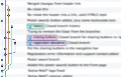

On the other hand, an interactive visualisation can be very useful if you’re dealing with a complex data interaction. Version control software which can display branch graphs often beat text interfaces here. For instance, this is a snapshot from one of my repositories:
branch graph
This is much more convenient than the text interface, even though this isn’t even a particularly powerful visualisation. But once again, note that actually manipulating the repository is faster using the command line (at least for me). I use the GUI just to display the branches.
