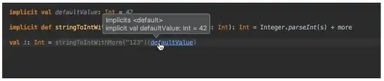

Use implicit hints in IntelliJ.
Janek Bogucki
