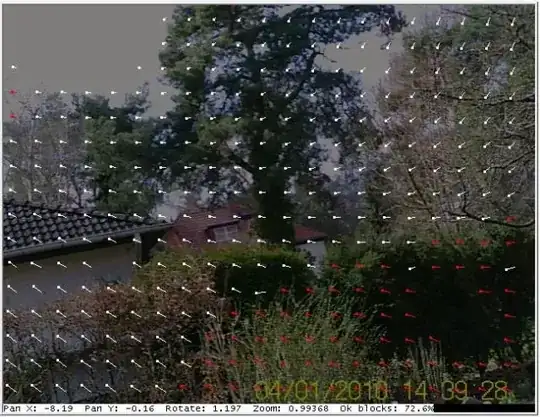

    In order to understand how prediction works, take a look at this image. It is created by a deshaker plug-in for VirtualDub, and used for a different purpose (detecting camera shakes), but it seems very representative:
    Deshaker
    The arrows indicate how the current image differs to the previous one;
    The entire frame is split into macroblocks (larger than 16x16, however);
    The difference for each block, compared to the previous image, is a movement vector;
    As you see, most macroblocks (white arrows) follow the common pattern, and therefore they can be encoded by only applying a transposition matrix to a previous frame.
    However, there are some blocks (red arrows) do not comply with the common pattern, and therefore they must be encoded as-is.
    Of course, if everything is red, there's no choice other than encoding the entire frame as-is.
