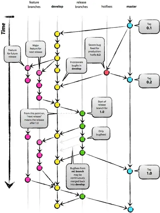

Good practices to follow
A successful Git branching model by Vincent Driessen has good suggestions. If this branching model appeals to you consider the flow extension to git. Others have commented about flow.

I have found many, many, useful blogs and posts to learn from. However, the ones that are professionally illustrated are rare ones. Thus, I would like to recommend a post - A successful Git branching model by @nvie. I have borrowed his illustration :)

    It is worth noting that many projects do not have a need for some of the lanes shown in this diagram. Some projects only need what's called develop and feature here. This is often true for web apps that can be deployed at will. – usr Sep 01 '19 at 11:51
    Even the author of git flow no longer recommends it for many project types, such as web development. Many people believe it is much more complex than the vast majority of projects need, making it troublesome to execute and easy to get wrong. At the other end of the spectrum, some advanced practitioners advocate teams use 'trunk based development', which almost never uses branches at all, and deliver successful projects like that. For something intermediate, consider "anti-gitflow' – Jonathan Hartley Oct 16 '20 at 03:38
  • Hi @JonathanHartley can you please provide a link to that reference about the Git Flow author depreciating Git Flow for some project types? Sounds like a good reference to support improvement in some organisations, or perhaps you were referring to: https://nvie.com/posts/a-successful-git-branching-model/ – NeilG Nov 17 '22 at 23:06
    @NeilG I suspect I was thinking of the link you provide, or one very like it, in which the author of git-flow says "If your team is doing continuous delivery of software, I would suggest to adopt a much simpler workflow (like GitHub flow) instead of [...] git-flow." – Jonathan Hartley Nov 18 '22 at 05:28
