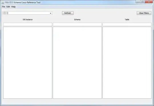

For example, the project I chose was a tool that cross-references the database instances, schemas and tables in a huge enterprise application containing 140 db instances, several hundred schemas and thousands of tables. Sometimes when looking at unfamiliar code you have a table name but finding which instance and schema it's in is a chore.
The tool displays 3 columns: DB Instance, Schema and Table, and each column contains only unique names. When you click on a table name (for instance) the schema and instance columns get filtered showing where that particular table occurs. Clicking on a schema name or instance name results in similar filtering behavior on the other two columns.
Schema Crossreference Tool UI Sample
I have a backend model containing a three-level tree (Instance, Schema, Table) but this is inappropriate for the UI I want to display. So I have a second "display-model" that is built from the backend model, and backs the three columns. That is where I store flags indicating which entries are visible based on user input. The two models are significantly different in structure, and the display-model entries contain references to the backend-model entries. In a sense the display-model entries are adapters that allow the backend-model entries to be handled in a display-appropriate way.
