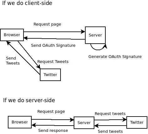

If we do exactly what Twitter suggests, the only difference between this and doing everything server-side is that our server won't have to contact the Twitter API anymore every time the user wants to view tweets. Here's how I would picture what's happening every time the user makes a request:

If we do it through Javascript, it would be harder on my part because I would have to create the signatures manually for every request, but I will gladly do it if the boost in performance is worth all the trouble. Doing it through Ruby on Rails would be very easy since the Twitter gem does most of the grunt work already, so I'm really encouraging the other people in the project to agree with me.
Is the difference in performance trivial or is it significant enough to switch to Javascript?

Your performance gain are going to come from Scaling up, (if you need to). Imaging you have a whole lot of users Option 2 would cause server side bottle neck much sooner than option 1.
Small scale where the server would have no problem with the load, the performance gains would be negligible.
