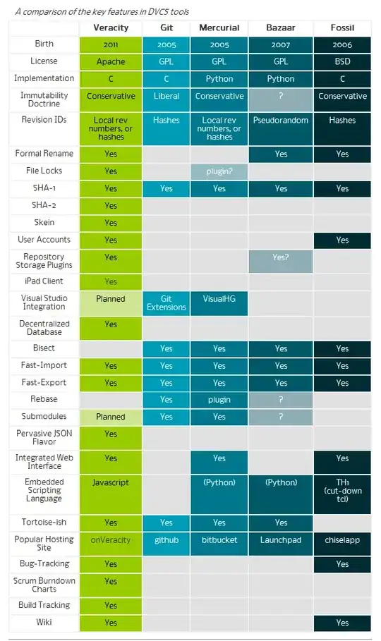

You can also find a great table comparing the Big Kahunas of source control on Veracity's official website:
http://veracity-scm.com/
