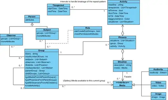

Here's the design I have: Class diagram with methods included. The "Group" class is the hierarchy
The "Phoenix"-class is named that way because I didn't think of an appropriate name yet.
But besides this I need to be able to hide specific activities for specific observers, even though they are attached to them through the groups.

  • Now that I've seen your diagram, what's your question exactly - if it's about the design approach I can't really help you at this point since I'm new to the various design methodologies, myself. However if you're looking for efficient `O(n)` algorithms for a well-defined data structure I can work on that. I see you didn't put in any mutating methods on `Group` and the structure of the hierarchies. Am I to assume that these will be static? –  Aug 16 '12 at 12:42
  • I'm sorry, I don't know what a "mutating method" is (and [Google](https://www.google.com/search?q=mutating+method+wiki) just shows a bunch of error questions), but the 4 methods shown on `Group` won't be static, if that's what you're asking. And well, I think it's mostly a design issue, at least at first hand. At least I won't call my design a "well-defined data structure" by any chance yet. Anyway, you're saying you would be able to optimize the time complexity of already defined implementations, right? –  Aug 16 '12 at 14:06

Your diagram looks generally ok to me.
