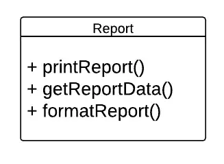

Report class
I have added a sample class that clearly violates the SRP. It would be great if people could use it as an example to explain how they approach the single responsibility principle.
The example is from here.

The SRP states, in no uncertain terms, that a class should only ever have one reason to change.
Deconstructing the "report" class in the question, it has three methods:
  • printReport
  • getReportData
  • formatReport
Ignoring the redundant Report being used in every method, it is easy to see why this violates the SRP:
  • The term "print" implies some kind of UI, or an actual printer. This class therefore contains some amount of UI or presentation logic. A change to the UI requirements will necessitate a change to the Report class.
  • The term "data" implies a data structure of some kind, but doesn't really specify what (XML? JSON? CSV?). Regardless, if the "contents" of the report ever change, then so will this method. There is coupling to either a database or a domain.
  • formatReport is just a terrible name for a method in general, but I'd assume by looking at it that it once again has something to do with the UI, and probably a different aspect of the UI than printReport. So, another, unrelated reason to change.
So this one class is possibly coupled with a database, a screen/printer device, and some internal formatting logic for logs or file output or whatnot. By having all three functions in one class, you're multiplying the number of dependencies and tripling the probability that any dependency or requirement change will break this class (or something else that depends on it).
Part of the problem here is that you've picked a particularly thorny example. You should probably not have a class called Report, even if it only does one thing, because... what report? Aren't all "reports" completely different beasts, based on different data and different requirements? And isn't a report something that's already been formatted, either for screen or for print?
But, looking past that, and making up a hypothetical concrete name - let's call it IncomeStatement (one very common report) - a proper "SRPed" architecture would have three types:
  • IncomeStatement - the domain and/or model class that contains and/or computes the information that appears on formatted reports.
  • IncomeStatementPrinter, which would probably implement some standard interface like IPrintable<T>. Has one key method, Print(IncomeStatement), and maybe some other methods or properties for configuring print-specific settings.
  • IncomeStatementRenderer, which handles screen rendering and is very similar to the printer class.
  • You could also eventually add more feature-specific classes like IncomeStatementExporter / IExportable<TReport, TFormat>.
This is made significantly easier in modern languages with the introduction of generics and IoC containers. Most of your application code does not need to rely on the specific IncomeStatementPrinter class, it can use IPrintable<T> and thus operate on any kind of printable report, which gives you all of the perceived benefits of a Report base class with a print method and none of the usual SRP violations. The actual implementation need only be declared once, in the IoC container registration.

In your example, it is not clear SRP is being violated. Maybe the report should be able to format and print itself, if they are relatively simple:
class Report {
  void format() {
     text = text.trim();
  void print() {
     new Printer().write(text);
The methods are so simple it doesn't make sense to have ReportFormatter or ReportPrinter classes. The only glaring problem in the interface is getReportData because it violates ask don't tell on non-value object.
On the other hand, if the methods are very complicated or there are many ways to format or print a Report then it makes sense to delegate the responsibility (also more testable):
