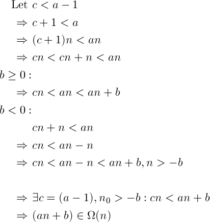

Proof
If you are really trying to prove this, you need to show using the definitions of the Landau notation that your function satisfies the necessary conditions.
So you need to find values for c, d, n_0 such that the condition holds.
Here is how you can do that for the lower bound with c:
proof
It is important to realize, that me arbitrarily defining c as being smaller than a-1 is perfectly fine. The definition of Theta(g) says that "there exists a c". It can be any value as long as it is bigger than 0. (If a is a positive real number, you would need to change the proof slightly however, because a - 1 might actually be negative)
(I am assuming a to be positive, otherwise the function will always be negative for big values of n, which makes no sense for a function denoting the runtime.)
You can try doing it for the upper bound, it's quite similar. If you don't know how, I can provide a proof for you.
Hint: start with d > a + 1
