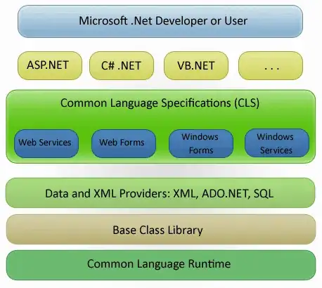

Common Language Specification is a key
It would be better to enhance your understanding of how to write a Common Language Specification (CLS) compliant code. I believe that would resolve most of the issues that you have faced or found.
Basically, CLS compliance refers to CLS rules and restrictions that being followed. However, the concept has a more specific meaning depending on whether you are describing CLS-compliant code or CLS-compliant development tools, such as a compiler. CLS-compliant tools can help you write CLS-compliant code.
