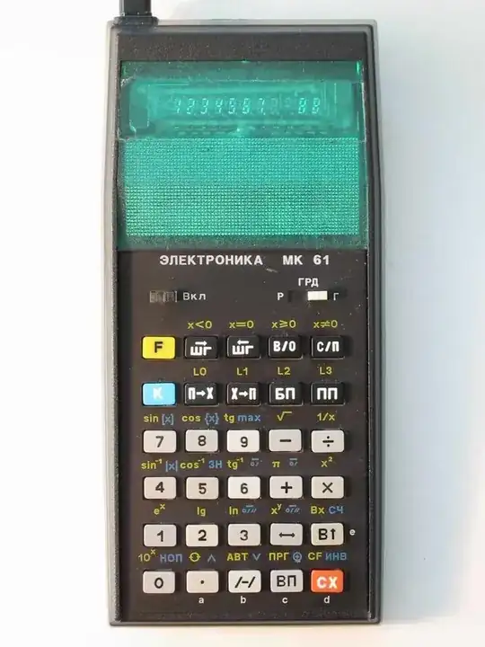

In my childhood I used to program on an MK-61 Soviet calculator. It had four operating registers (X, Y, Z, T) and 15 storage registers. A program could have 105 steps.
As I recall it, it had commands like:
  • Swap X and Y registers
  • Shift registers (Z to T, Y to Z, X to Y)
  • Copy from storage register (1..15) to X
  • Copy from X to storage register (1..15)
  • If X < 0 then go to program step ##
  • Perform operation (+, -, *, /) using X and Y values and put result to X
Is this command set an assembly language? Did I have a basic idea of assembly languages by using this device?
Device
It turns out it is something called "keystroke programming".

  • Nice! - that picture brings back memories. I still got my MK-52 in the basement somewhere :) – DXM Dec 13 '13 at 21:40
  • This looks like a Soviet clone of the HP 65. It may be programmed in Reverse Polish Notation with operations that push and pull on a stack. The RPN operators are simply recorded in memory, and interpreted by a what is probably equivalent to a 4004 CPU. The code in the 4004 ROM was probably compiled from 4004 assembler, but the keystrokes are really more like spreadsheet macros. – Meredith Poor Dec 14 '13 at 05:38
