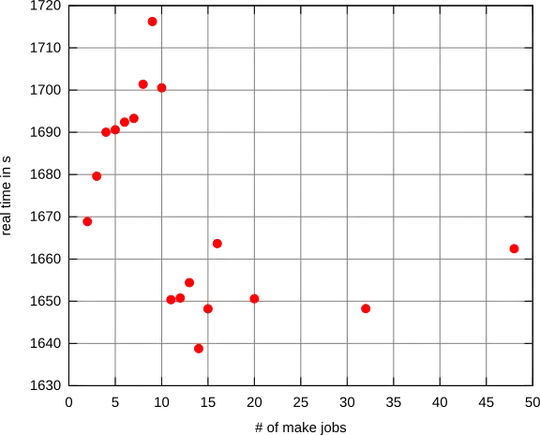

I ran a series of tests, building llvm (in Debug+Asserts mode) on a machine with two cores and 8 GB of RAM:
compiling llvm time depending on number of jobs
Oddly enough, it seems to climb until 10 and then suddenly drops below the time it takes to build with two jobs (one jobs takes about the double time, not included in the graph).
The minimum seems to be 7*$cores in this case.
