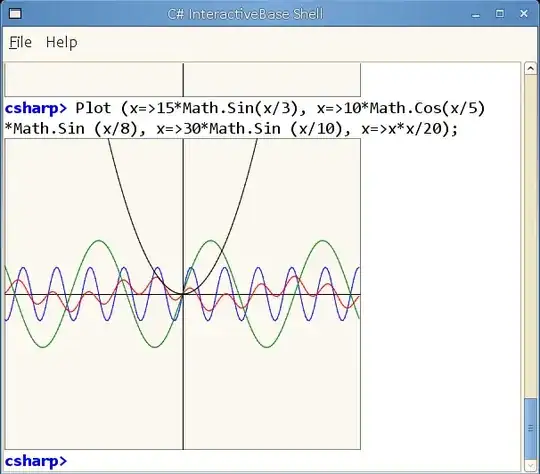

Mono has a C# repl: http://www.mono-project.com/CsharpRepl
It even has a GUI version that allows you to directly manipulate graphics objects, or create Gtk# widgets:
