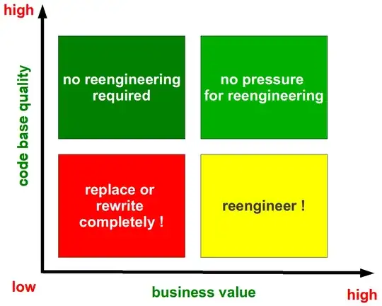

A rewrite is not the same as a reengineer.
I have posted this in other similar questions.
This chart could help sell the idea of a rewrite/replace/reengineer, it's a function of code base quality and business value of the application:
Tulains Córdova
