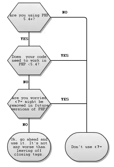

Should you use <?=?
flowchart about whether or not to use the short echo tag

    I disagree with your snappy diagram. The correct answer is **99.99% YES** because most production environments are configured to use short tags. Supposing you blew it and they remove `=` in the future you can fix it in less than a minute, no matter how many thousands of files use it, you just do a project-wide search & replace of `=` for ` – dukeofgaming Jun 08 '12 at 00:07
    @dukeofgaming, where are you getting your data about production environments being configured to use short tags? Disabling them is one of the most commonly suggested configurations that I've heard about, second only to disabling magic quotes. It also would make absolutely zero sense to have a dev environment that's different from production. – zzzzBov Jun 08 '12 at 00:11
    Short tags were enabled by default until 5.3 http://www.php.net/manual/en/ini.core.php#ini.short-open-tag, most hosting services I know supported it with no problems and this was one of the reasons the Kohana framework used to encourage it. `=` will always be on (http://stackoverflow.com/a/6064813/156257) and most of the time they used to be on. You can prove me wrong by checking with your host if: they are disabled and using PHP < 5.3 *and* if they don't allow the setting to be overriden by users or upon special request; if all the previous is false, by all means worry about `=`. – dukeofgaming Jun 08 '12 at 01:30
    @dukeofgaming, did you actually read my post? I personally support the use of `=` but due to the volatility of `` when mixed with XML, it's a common setting to override. It's an important distinction as to whether you're writing code for a library or personal use. If it's a library that needs to be backwards compatible, you simply wont be able to get away with short open tags. If you're just writing a template for your own drupal or wordpress blog, by all means, go ahead and use em. – zzzzBov Jun 08 '12 at 01:40
    Yes, I did, and as I said, I just disagree with your snappy diagram. Particularly in the last part of the flow, because it won't disappear and there is no need to worry, in the drama-oriented PHP mailing list community this feature has no enemies whatsoever, and **tell you what, if it disappears I'll start a 200 Rep bounty for you to cash-in from this answer**. – dukeofgaming Jun 08 '12 at 17:35
    You're not worried that `=` will be removed, and neither am I. Others might be, and if they are, they don't have to use `=`. Some people have irrational fear of using certain language features ([like leaving off closing tags in php](http://stackoverflow.com/questions/4410704/php-closing-tag/4453835#4453835)). – zzzzBov Jun 08 '12 at 18:11
    That's precisely my point: *there is no need to worry*. I'd just put "Are you worried?" --yes--> "Go ahead and use them, there is no need to worry". It also feels like you are implying that leaving off closing tags is a bad practice, which is not. – dukeofgaming Jun 08 '12 at 19:14
    Comments aren't the right place for this discussion, if you're interested in continuing, send me an email and I'll be glad to discuss this further. – zzzzBov Jun 08 '12 at 19:16

    That flowchart could be massively simplified now - nobody should be using PHP < 5.4 anymore, and the short echo tag has remained since (it has even outlasted the short open tag option). There's no path other than "go ahead" now. – thomasrutter Dec 28 '18 at 12:16
  • @thomasrutter if you follow the flow chart it is as accurate today as it was 6 years ago. Just because most people get a "yes you should use `=`" result doesn't mean the logic has changed. – zzzzBov Dec 28 '18 at 12:40
    I was not commentimg about its accuracy. – thomasrutter Dec 28 '18 at 14:11
