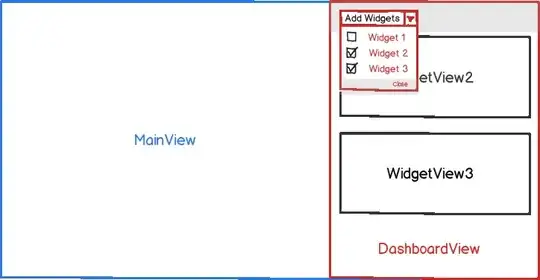

I am building a Flex 4 based application using the presentation model design pattern. This application will have several different components to it as shown in the image below.
The MainView and DashboardView will always be visible and they each have corresponding presentation models and models as necessary. These views are easily created by declaring their MXML in the application root.

There will also be many WidgetViewN views that can be added to the DashboardView by the user at runtime through a simple drop down list. This will need to be accomplished via ActionScript.
The drop down list should always show what WidgetViewN has already been added to the DashboardView. Therefore some state about which WidgetViewN's have been created needs to be stored. Since the list of available WidgetViewN and which ones are added to the DashboardView also need to be accessible from other components in the system I think this needs to be stored in a Model object.

MVP is somewhat open to interpretation. I've written a large scale Flex 3 app with MVP so I'll give my input based on experience.
From the presenter's perspective it would be the view's responsibility to add subviews (because views are interfaced -- think console app replacement). Nothing view-specific should exist in the presenter (ie. you should be able to unit test it having a mock view).
You are correct, the main view shouldn't be doing this either.
The presenter for that view would assign a WidgetPresenterCatalog (populated elsewhere in the application based on business logic) that the view can choose from. The view would delegate all widget presentation, selection, and interaction to your DashboardView component. That component selects from the catalog and displays them.
Problem #2 - how to display them! The same way you connect a presenter and a view. You have a class that knows how to couple a presenter and view and return the view for presentation. Again, the presenter would pass this to the MainView and the MainView would provide it to the DashboardView.
Now your MainView and Presenter should be ultra lightweight and the widgets have very little surface area on them.

Per Martin Fowler's explanation of the Presentation Model ( http://martinfowler.com/eaaDev/PresentationModel.html ), I believe the answers are as follows:
FWIW, I'm not an expert in the Presentation Model pattern.
1) Would be in your DashboardPresentationModel since that holds the presentation logic for your program. That logic would then determine whether the widget is allowed or not, as well as making the subsequent instantiation.
2) If I understand your layout correctly, then I believe the answer is no. The PresentationModel should contain that information and, if necessary, provide methods for accessing that information.
3) Sorry, don't know.
